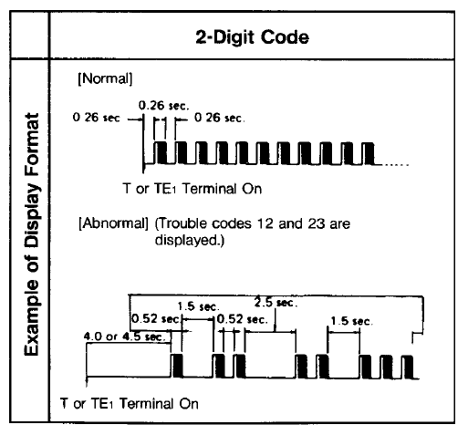

    Checked the code and have no idea what this means???:
    Flashed 3 times, pause.
    Flashed 4 times, pause.
    Flashed 5 times, pause.
    Flashed twice, pause then repeat.
    Anyone know?

    Boost and Knock Sensor?
    The codes are two digits each... there should be a longer gap...

    Here are the error codes for the 1g-ge, should be the same for a 1g-gte.
    It looks like the error codes you are getting are 34 and 52, and both of them are not on the list
    However if we take a look at the error codes for the 7m-gte :
    http://www.cygnusx1.net/Supra/Librar...aspx?S=FI&P=28
    Code 34 is "Turbocharger Pressure is abnormal".
    Code 52 is a problem with the knock sensors, "Open or short circuit in knock sensor signal"
    So just like Wilbo said, Boost and Knock Sensors.
