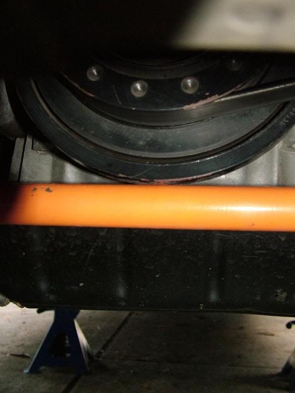

    It certainly does on mine. I'm using JZX81 Al. legs combined with JZA80 isolaters. My front sway bar is a 27mm K-Mac, so maybe the bigger front bar is the problem??
    This image shows how much clearance there is when the car has all four wheels on the ground.
    And now this shot shows the suspension at full droop which on my car results in the sway bar and harmonic balancer getting intimate.
    Given that this is happening on some vehicles and not others it may just be due to differing suspension arrangements. My bar only just contacts the balancer on full droop so if you had less droop, i.e using coilovers, it wouldn't be a problem. Also if you were running the standard bar you'd still have a few mm of clearance........or just maybe my Kmac is cacky and has a weird bend to it??
    Oh well guess that rules out General Lee impersonations in my cressie
    Pete
    Least it doesnt snore Backyard Mechanic Gary's Avatar
    308
    Default Re: How did you beat your tunnel. R154 into X83
    doesnt come nearly that close in mine, and ive got exactly the same as you - x81 alloy mounts, a80 TT rubber mounts... my swaybar is stock though
