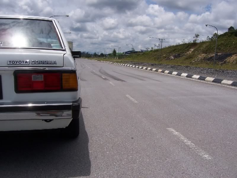

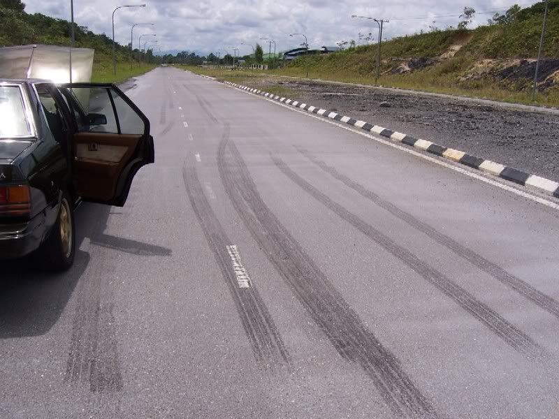

    yesterday went to do some testing on my KE70. i found out that it launch stupidly sideway at first 2 gears with the car barely moving. it just wheel spins and move sideway toward driver side. my car has open diff 4.3 toyota E series axles.
    i can clearly see there were 2 tires marks on the pavement, does this means both tyres having traction? if that is not the case, can a welded diff improve the first 2 gears launch better?

    If you have 2 tire marks on the pavement on launch then it sounds like both wheels spinning. On an open wheeler diff that may or may not signal trouble down the track but is besides the point here!
    Your car will be trying to head right on launch because it is doing the normal trick of lifting the drivers side wheel thus leaving most of the tractive effort being put down by the passenger side wheel.
    To counteract this I use a heavy duty swaybar which I preload so the drivers side wheel is being planted into the road/racetrack. It will depend on how your swaybar mounts (if you already have one) as to how you accomplish the preload. On my old setup the swaybar mounted directly to the lower trailing arms so I was able to use a threaded rod and a bunch of nuts to force the arm down on one side (sway bar was held captive in 2 places to each trailing arm - bolted at the front and u clamped at the back).
    The aim is that when you measure dead centre under the diff and jack the rear up using a socket between diff and jack to allow pivot the passenger side wheel should lift off the ground first and have about an inch of clearance before the drivers side wheel comes off the ground.
    If you hadn't guessed this will of course leave the car with a slightly lopsided - down on the left rear - look but is the simplest way of getting both wheels driving to the bitumen and a straight launch. You may be able to make a simple setup to allow quick preload when you know some drag launches are in order!

    At the simple end of things, it sounds good (for now) that you're getting two black marks, that means both tyres are spinning. I'd recommend a locker for a drag car so you know both wheels will always spin, but it has many downsides on the road.
    But to get a better launch (without changing your setup, that's been well covered above) you need to balance your clutch and throttle so you take off smoothly without the engine bogging down or too much wheelspin. You may find you aren't able to floor the throttle until midway through second, otherwise it just ends in crazy wheelspin.

    but back to topic, if i can get 2 tyre marks on the pavement during the launch, it means that both wheel having the same surface friction right? does this means i don't need a welded diff yet?
    Victoria, Mt Macedon
    1,134
    Default Re: bad launches..
    Yeah, I agree. Sorry it was a bit hard to understand, but I meant just welding up your current centre. I have heard rumours of a rare E series LSD, but personally I don't believe them.
    And yes, you have both wheels spinning now, but maybe with a smoother (but also faster) launch will you start to get a single wheel spinning. So I think you need more "testing" before deciding to weld or not.
