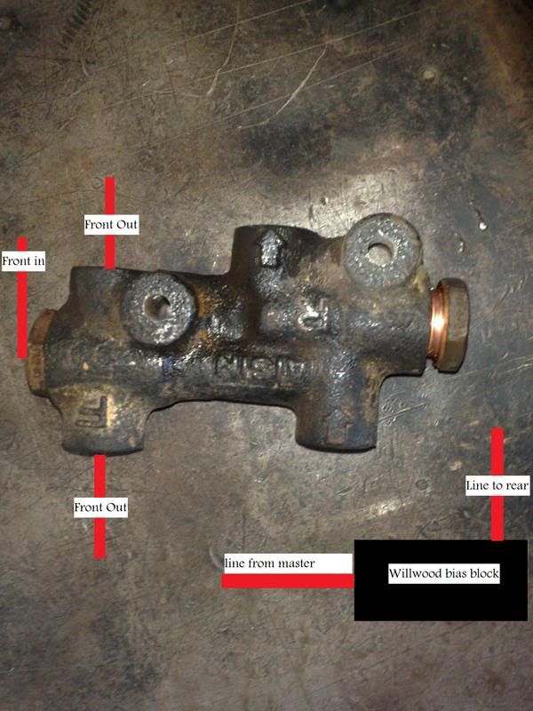

    but with what BillZilla has said fresh in mind, i was thinking...can i gut the bias adjuster, so that the pressure is split equally between all lines, then simply add the Willwood adjuster on the rear line after the now gutted standard bais block?
    hope that makes sense
    36
    Default Re: Gutting Brake Bias
    With the ADM bias adjuster, it is basically 2 parts in one. One half is the splitter for the front brakes, and the other part is the rear bias control. When you gut the bias control part, you can leave the rear in/out lines disconnected, basically just using the top half of the body as a splitter, and run the original rear in/out lines into the Adjustable Bias Controller, no new brake lines needed (If you buy a bias adjuster with the correct threads) and mount the Adjustable unit on the side of the old unit.
    I have done exactly as you have said, running the adjuster in front of the gutted unit, for whatever reasons I had at the time. That works fine. Others have pinched a splitter from a diff, and used that for the front brakes, removing the old bias/splitter block completely.
    None of these changes will give you a better pedal though
    Your stock master cylinder moves X cc's of fluid through 1cm of travel, and when you are running bigger, multipot RX7 calipers where the single pot calipers used to be, your stock MC will just not be able to supply the required amount of fluid in the pedal travel you want.
    PS, new brake lines are pretty cheap, if you measure up and fit them yourself, just head to your local brake shop with your measurements, and a sample so they can match the threads, and they will make them up on the spot, you just need to bend them without kinking them, which is easy if you take your time and are carefull not to crimp the tubes at all.

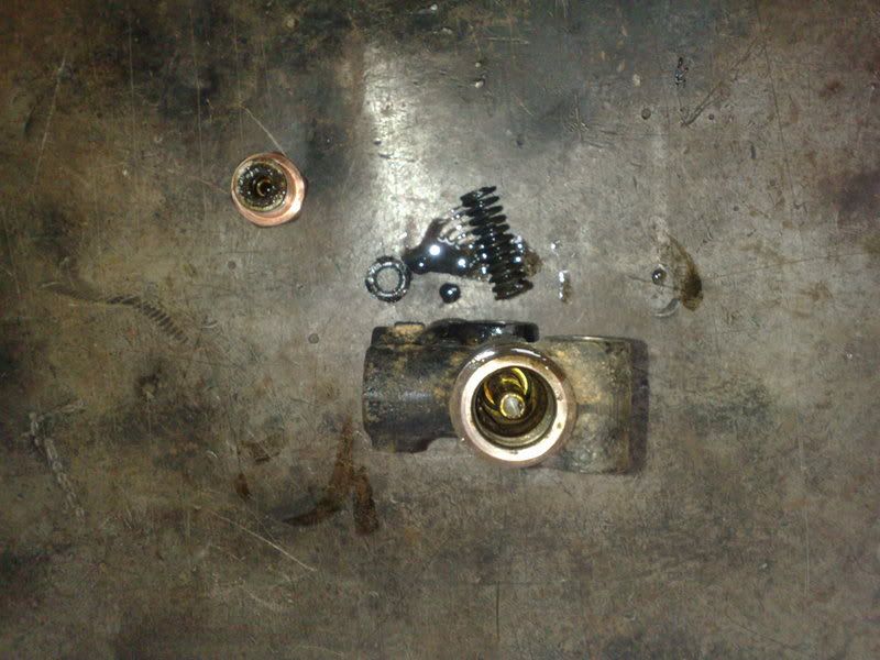

    so the top section doesnt flow through to the bottom section?
    so this is the rear bias section? and i just leave the spring out?
    so this is the layout that i have in my head from reading the above...
    will i need to plug the rear in/out on the bias block?

    so leave the stock proportion block intact and mount the willwood item in the rear line afterwards?
    Junior Member Backyard Mechanic bigmat's Avatar
    sa
    419
    i would try the system with the original valve in it first with biger mc and then go from there. unless someone else has done it before.
    then i would do one of these things
    i would gut the original prop valve to make sure it cant screw anything up in the system and fit wilwood rear bias valve to the rear line. that would be the cheapest option.
    best thing to do make new lines but that would cost $200 to $300 and fit bias valve
    cheers mat

    in the top pic i have put up, is that all that needs to be removed from the bias block?
    sa
    419
    thats what i would do. you might be suprised it might work.
