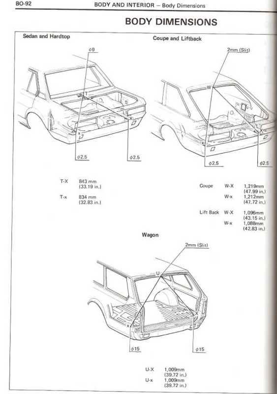

interesting!
would mean that the KE7 has 0.6deg or so less camber?
what abotu the difference in strut tops? can't remember exactly, but if you use e8 in e7, on the opposite sides, you get more camber or castor or something... ie ther eis a bit of offset there perhaps?

i just can't remember specifics as it was a long time ago.
