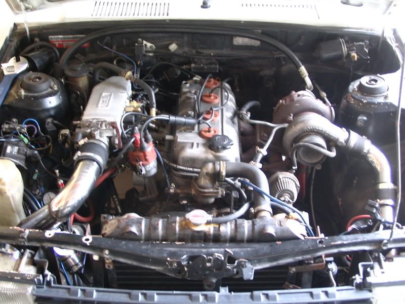

    i plan to plum the supercharger to my existing intercooler piping. so cooling is not a problem with the 600x300x76mm intercooler i guess. here is the photo of my current setup
    i've think to do a twin charged setup, where i can relocate the alternator onto the intake side of the block, where as the SC will be mounted just underneath the turbo. SC -> Turbo -> Intercooler -> inlet throttle.
    what do you guys think?

    need larger exhaust housing on turbo, as you only want it to make maybe 5psi or so. also want to resize the compressor, to be more efficient at larger flow and lower pressure...
    cos the SC will multiply the boost if in series.
    but could be good option.
    i was meaning heat produced in the SC.. making it inefficient..
