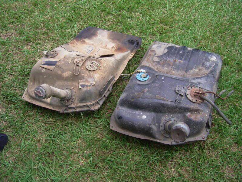

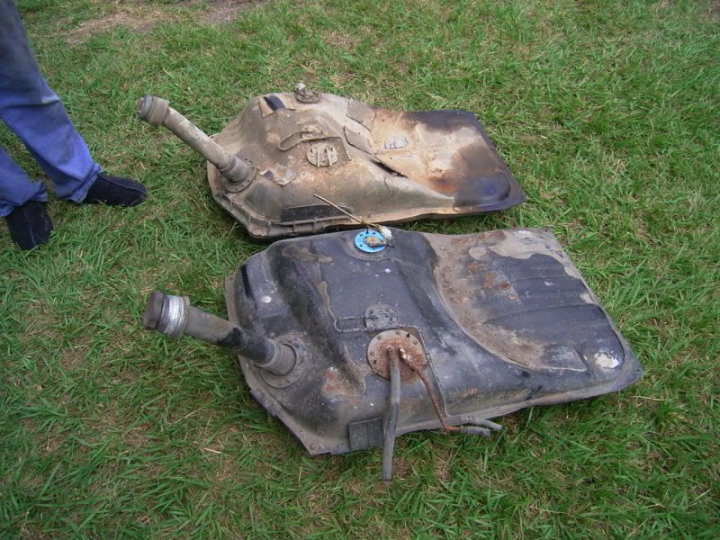

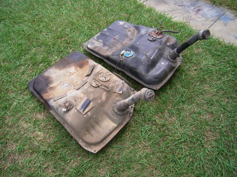

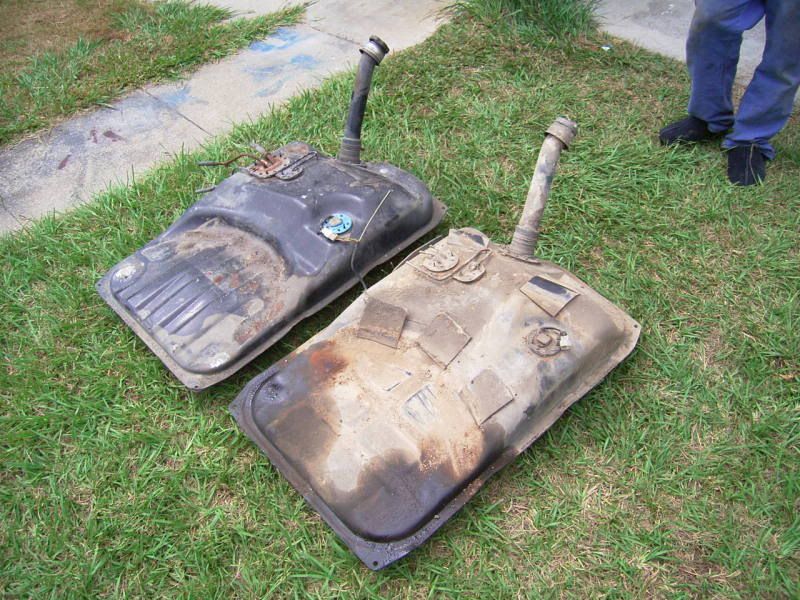

come across a couple of threads talking about the difference between fuel tanks in celica's, corona's, supra's, soarer's, cressida's etc... so i thought i'd start a thread where if you got one laying around, take a couple of pics and hopefully when someone goes to convert say a Ra60 carby to Jza60 EFI they might not have to pull there hairs out looking for a ra65 tank when they could use... say an mx73.
prob a dumb topic but might be helpful on day.
first comparison
Gz10 to Ra60
*** Ra60 21RC (the dirty one) Gz10 1GGEU (external fuel pump).
