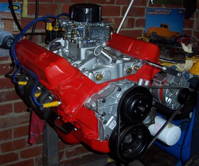

    5mge horsepower - 165 and these Toyota differentials are capable of lots more.
    253 Holden horsepower - 185
    253 Holden engine for our rod and no other engines as we already have it all setup.
