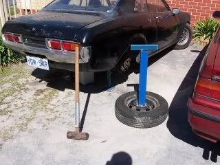

    863
    Default Re: disassembling a supra diff G299 torsen
    make urself one of these
