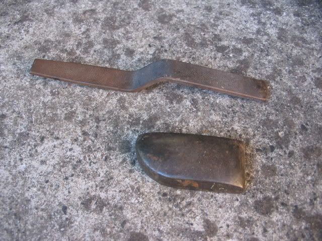

    I made my own flipper at trade school and still have it now, 14" bastard file, heat up the middle area with an oxy then put 2x 45degree bends to form a handle then grind the handle area flat so that you're not filing your skin off when you use it.
    alex, can you or someone else post a picture? google images is letting me down and constantly showing me dolphins and a lady with extraordinarily large breasts
    this is my flipper and dolly

    Cheers guys, I have previously only used a 'soft' base for stretcing, shot/sand bag. I grabbed a file to turn into a s/flapper and some .8 wire but ran out of time to try it out today, so it will have to wait till the weekend.
    Interesting that you leave the teeth on the s/flapper, the main book I've previously referred to used a polished surface one, so as not to mar the surface. Although he says he uses that s/flapper for smoothing the surface after forming.

    If you use a sandbag it's fine but the effect wont be as agressive, which is a good thing if you do'nt have much experience doing this kind of thing, so there is less chance of fudging it up.
    The idea behind leaving the file texture intact on the flipper is to stretch the metal, if it was smooth you would be just "planishing" (smoothing out the area).
