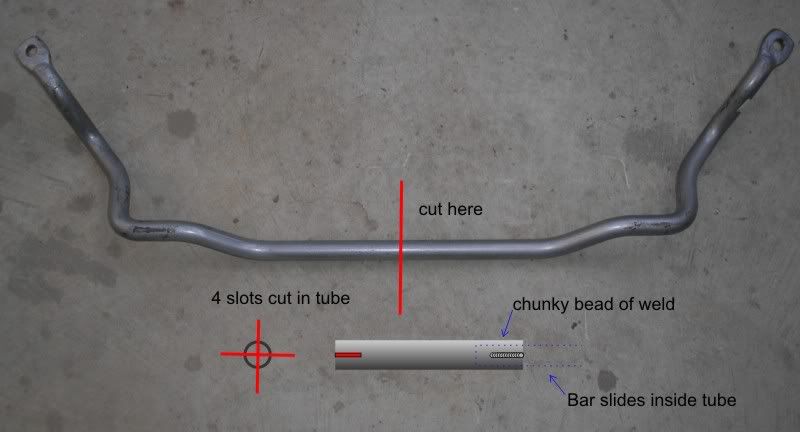

Interesting subject. I have seen welded sway bar/antiroll bars where the spring section is a straight, round bar and the arms the go to the lower control arms of the suspension are formed from flar bar that are welded onto the spring section.
Have also heard (read) of a an antiroll bar made from a thick walled stainless steel pipe in the same way. Unfortunately the guy who made it didn't/couldn't/wouldn't tell what grade of stainless it was.
Would be very handy to have Oldcorollas' input on the subject
