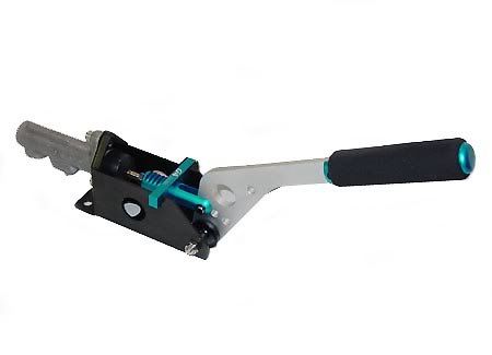

    hey guys,
    just spent most of my day today cutting/flaring/routing brake lines for my celica.
    its just your basic hydraulic handbrake system that you hook in line with the rear brakes,
    the cylinder on the handbrake is a 3/4 bore size, the brake lines are just the standar 5/16 and they are running to volvo twin piston calipers on the 240 diff,
    yet for the rear wheels to lock it takes avery effort in one arm to make it lock up, only 215/40/17 tyres on the rear aswell,
    what can i do to make it lock with alot less effort?
    same as this sucker here

    Put a 5/8" maso in there. and is the cyl in the same orientation as the pic? make sure its mounted upright.
    Brake lines should be 3/16"

    longer lever would help. Longer the better really.

    lever is long enough....same as most others out there,
    master is mounted upward with the lines running up from the cylinder then down through the floor....
    so you reckon a 5/8 cylinder will make it easier.....im clueless

    yep, use a 5/8 maso and it will be sweet.
    I have 1 here if you want to test it out before you purchase one, but it runs a 7/16 inlet and 3/8 outlet so make sure yours isn't metric otherwise it wont fit.

    As Linden noted, get a 5/8" master.
    My h/brake is a different brand to yours Blake and came with a 5/8" master cylinder standard, locks the rear end with no effort at all in the dry on semi slicks.

    sweet as, just spoke to just jap and they have a 5/8 cylinder on its way to me now
    cheers boys!
