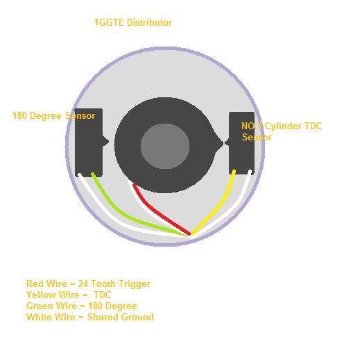

    I am wiring my new Microtech LT16 with X6 Ign Box into my van for my 1ggte and am just wanting to confirm which wires to use for the CAS wiring .
    Here is a drawing looking inside the distributor
    Wires from the Microtech Loom are as follows:
    Red - Trigger
    Green - Home
    Blue - Ground
    Yellow - Not Used
    Any Help appreciated.
    Dane

    'Trigger' is the sensor that looks at the 24 teeth.
    'Home' is the sensor that looks at the double tooth (not sure which one, try one, then the other)
    'Ground' is the common wire between them
