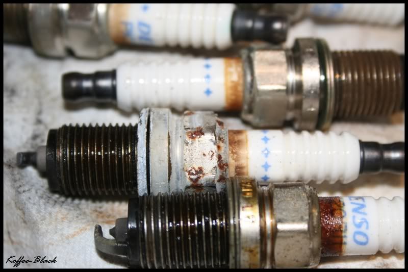

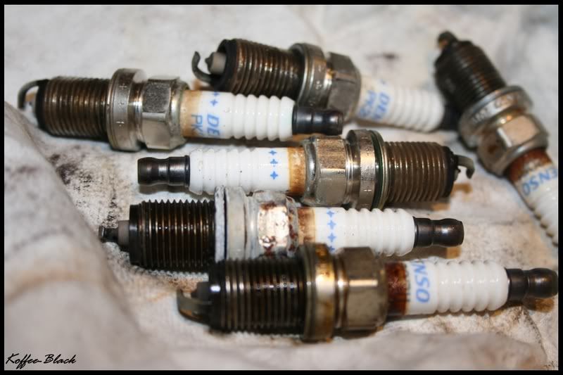

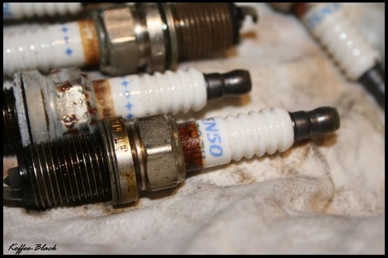

    Also i just did the front part of teh exhaust, so turbo back, high flow cat, and now the car is missfiring. Im hoping its the spark plugs, just tookt hem out, they seem old...and platinums?

    gap looks rather huge, make sure you set the new ones correctly ;-)

    i was thinking the gap too, but what should it be set at?

    0.8 is a good start

    yeh .8 is a good start but even .8 at 1.6 bar with stock ignition might have trouble, but some people get away with it.
