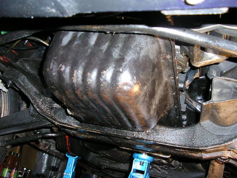

Triple check that you have EVERY bolt out of the sump.
Get a wide blade screw driver. Wide as you can. Edge it between the 2 surfaces and apply some pressure.
To help, get a block of flat wood and hold it against the side of the sump and give it a few short sharp wacks.
Let us know how you go.
) and going along the edge of it with a blade to try and loosen some of the super gasket goop thats on there but it just wont budge!
