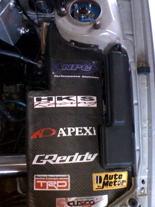

    oohh pick me pick me. i made my airbox from carbon fibre woven cloth. Which sounds like what you want to do.
    i made a template from cardboard (the stuff with 2 outer layers and the corregated stuff on the inside. I left the cardboard in there, i figured that its a good insulator and doesnt weight much, takes away fully sick induction note though
    I got the cloth from tamar marine which is a reasonably large marine/boating/diving suppliers/shop. It was $100 for a square meter from memory, that was a couple of years ago now.

    its not too hard, if you have done fibreglassing before you will piss it in.
    Its just the same procedure really, the biggest drawback is that its hard to see where you have put your resin, and its hard to see if you have enough on, as opposed to glass what goes clear etc. I used the same resin as i use for fibreglass too.
    as far as the shell went, i just got some cardboard and cut out each panel, then got some thick masking tape to stick it togther, i made a couple of these to get it right. Note in the pic how its curved, it was once flat, im assuming the resin and cf expanded causing the curve, i now have some bracing made from more cardboard and cf underneath, if i did this from the start im confident it would stop it altogther.
    NOTE the inside is just cardboard there is onlt 1 layer of cf.
