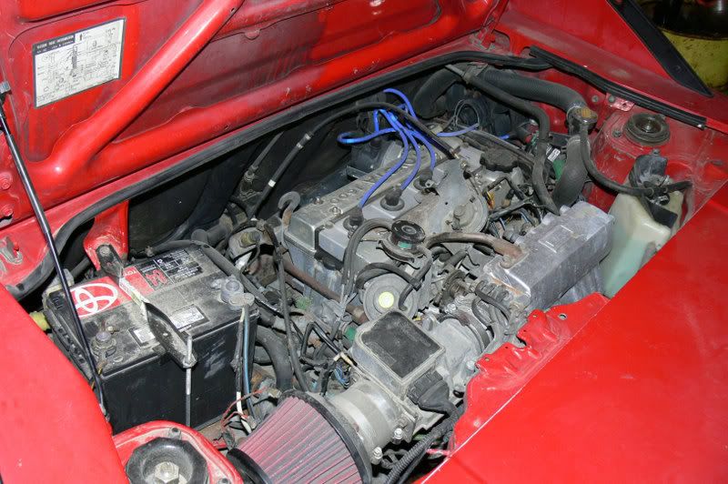

    there is an eco friendly alternative ive found, its called AB-50 its a green liquid your "supposed" to dilute 50:1 but ive been mixing it 4:1 in a spray bottle
    if you take a look at the top of the picture here you can see how i used it on half of the underside of my engine lid, i just sprayed and wiped off with paper towel, very very effective. only 2 issues with the product, it will remove ink from decals (my rad fill warning is nearly illegible now) and if you dont rinse alluminium it will leave that white salt-like residue. as you can see on my intake.
