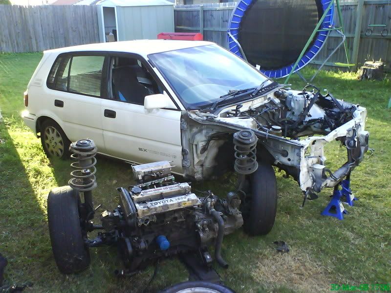

    Default Re: 1MZ rear main oil seal replacement.
    Either way i want to do it even more after today.
    This is what i did today with a mate.
    Only 2 hours work and it was relatively easy to lift the car off.
