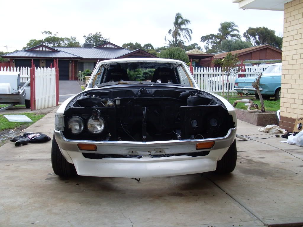

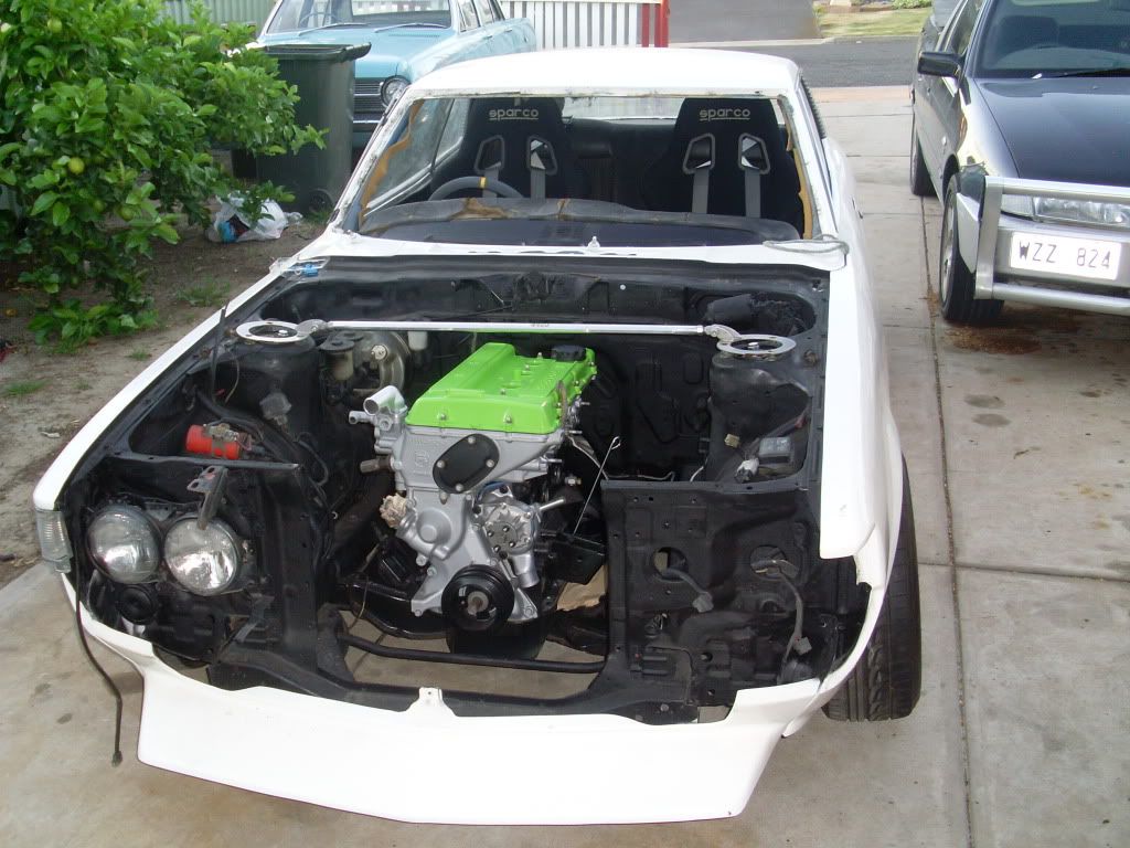

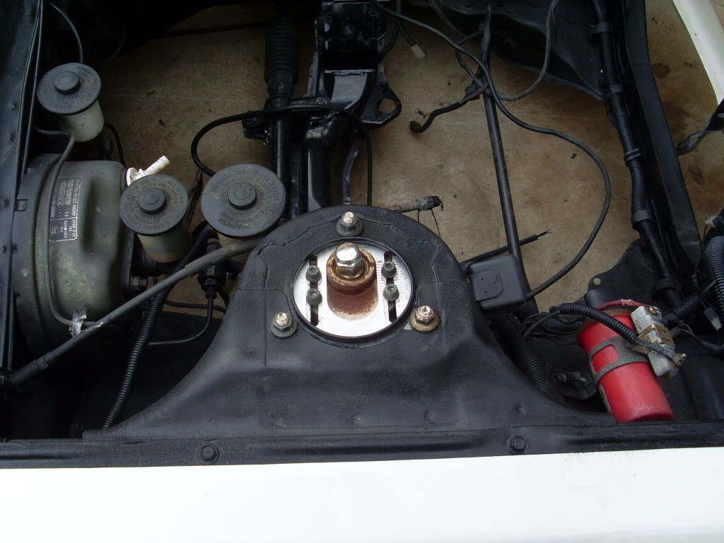

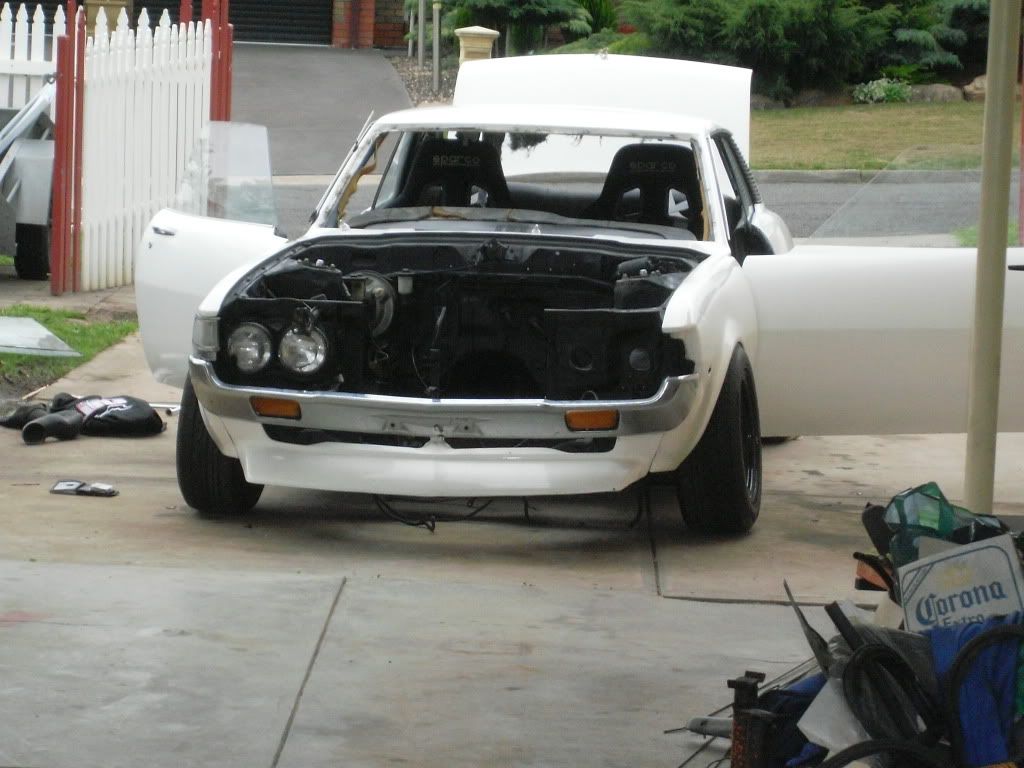

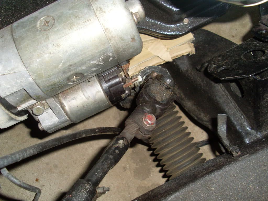

    this is my ra23..... i have ra60 crossmember and ke70 steering collom... i just cut and welded the plate down the bottom to get the steering collom in... only problem i found is the commlom for a ke70 is to short... which would be a problem if you wanted to retain the sotck steering wheel position.....
    my car is a race car so i wanted to gain the wider track and i have a removable bos kit and deep dish sparco steering wheel which makes the postion of the wheel perfect.....
    also i am running the s13 silvia front end with coilovers.... here is some pics...
    this is with the wrong starter motor fitted... correct one is now on there and all good
    and here is the postion of the collom... the key is really close to the dash but acceptable....

    Default Re: RA23/28 with KE70 steering column and rack and pinion
    ah makes sence..... i went ra60 for the simple fact that i have put an 18rg into an ra60 before and i know that the 18rg with a front sump bolts up the the crossmember in the stock position.....
    and here is a pic to clarfy that.....
    unfortunatly i have the early 18rg that doesnt have the second set of hold for the mounts to be moved back so i have to run a small peice of steel 5mm plate inbetween to make it bolt down....
    also what are you guys doing with sway bars? are you changing them to the ra60 item or ke70 one as it offers a bit of a kink to allow for the front sump..... mine is a fair way off atm but wasnt sure it if was enough....
    as you can sorta see on this pic..
