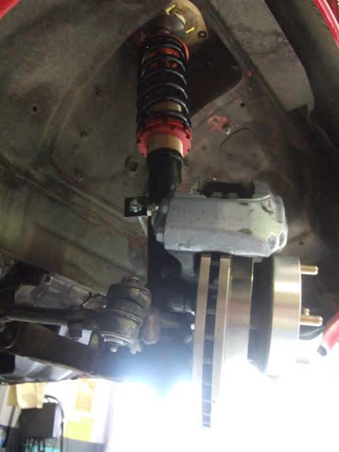

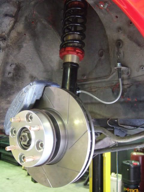

    custom coilovers on xt130 corona struts,
    MR2 SW20 rear KYB AGX externally adjustbale inserts, shorter stroke
    R33 skyline 4 piston calipers with custom bracket
    R33 skyline disc's 298mm x 30mm diametre's RDA slotted
    Braided brake lines
    machined hubs/discs
    standard xt130 wheel bearings
    RCA's (too be ordered)
    S13 jic Adjustable strut tops
    FRONT COILOVERS AND BRAKES MADE BY ROADRUNNER FABRICATIONS
