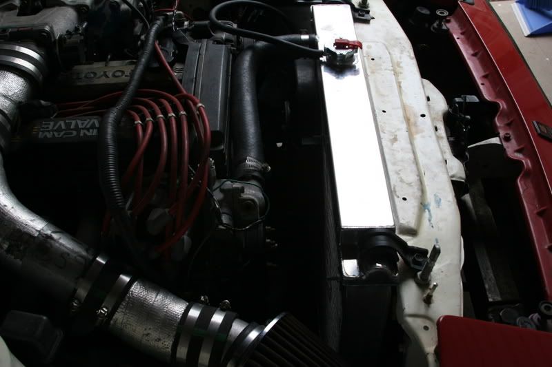

    Hey guys what has everyone done to avoid over heating in there 1jz-gte ma61's?
    mine is ok for normal driving but once you start to thrash it eg track day it stays quite hot.. does'nt come down unless i drive normally for a while.
    It has the stock ma61 radiator brand new!, twin thermo's, new thermostat and new coolant. and its only running a cooler at the front no air con so its got good flow.
    and tips or tricks?

    The biggest problem with the MA61 is the small frontal area, so it's hard to get adequate airflow through the radiator. I've tried nearly everything with mine and it still gets hot after a thrashing, so my next idea is to install bonnet vents to extract hot air from behind the radiator.
    If you don't want to go to that extreme I found the engine oil cooler helped things a bit. Mine is a small one but if you used a bigger one I think it could make a significant difference. Disconnect the water-to-oil cooler behind the oil filter and it will take some of the load off the cooling system.

    PWR 57mm Radiator for a MK3 with 2 12 inch SPAL thermo fans. Thermos are pointless unless sitting in traffic stopped for 3+minutes
