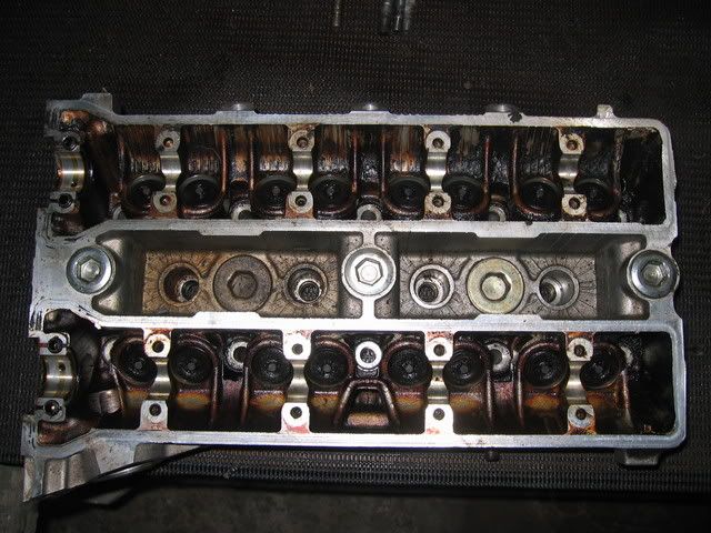

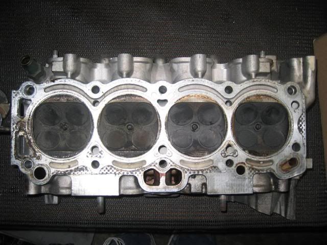

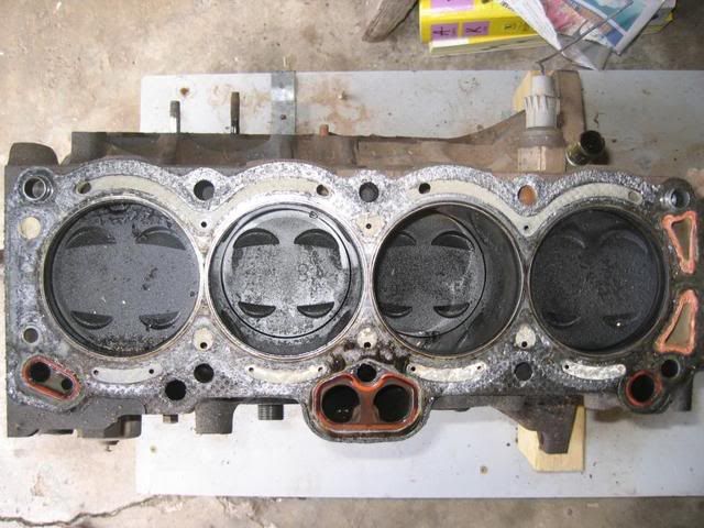

    This weapon combination of choice was used for the head. Since I don't have an engine stand and the engine is just sitting free on a piece of timber, I had to stand it next to the wall to stop the whole thing moving/spinning around while I cracked the bolts. I know an extension plus small socket is probably not the best choice for torquing up a head so I will get some long sockets for that.

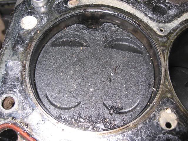

    Then to my suprise we reveal this! A great big chunk out of piston one down to the top ring
    Not to mention the stuffed combustion chamber!
    Luckily I had planned for new pistons, but getting a new head wasn't what I had hoped - although I was fortunate enough to pick one up off the forums in great nick!

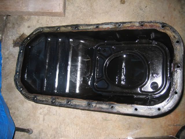

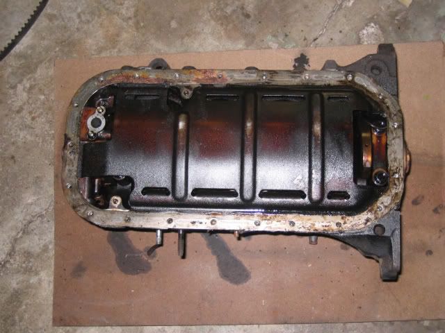

    Been a while since an update - work is getting slower...

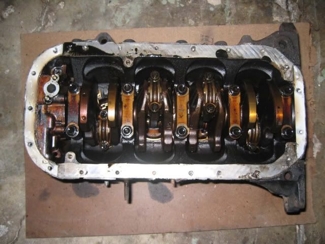

    Block flipped over and off comes the sump

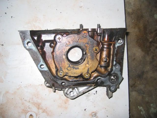

    Removed oil pump

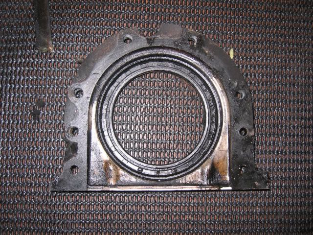

    Removed rear oil seal and retainer

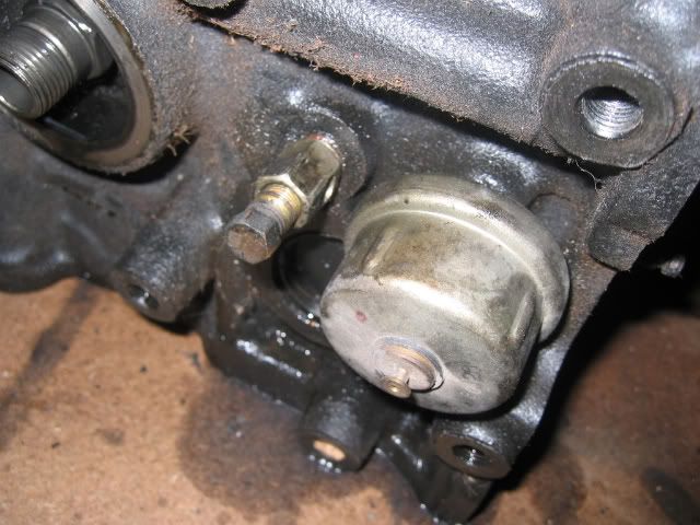

    Still need to remove the oil pressure sender and coolant drain valve

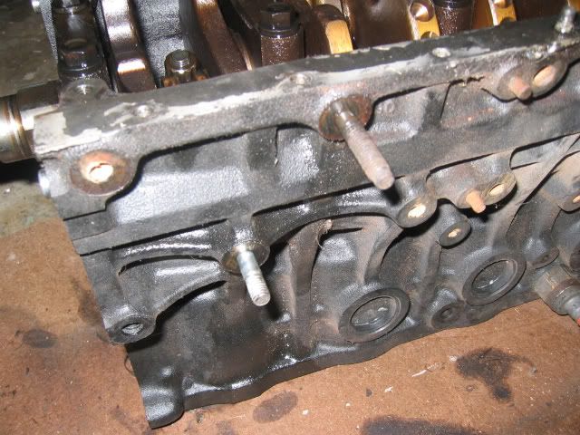

    I've also been putting off removing all the miscellaneous studs around the block and head as i'll be buggered if I know what length studs go where when I put them back in

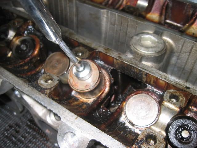

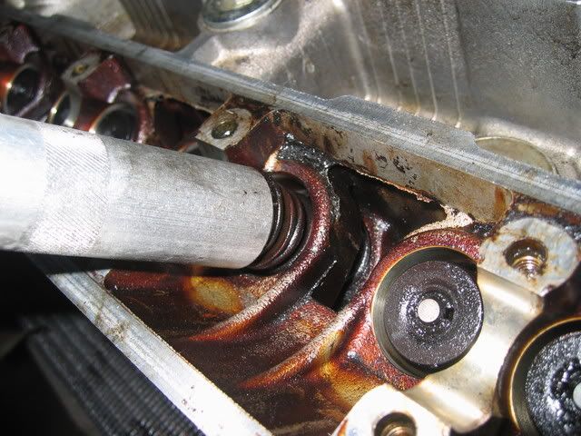

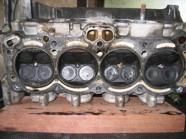

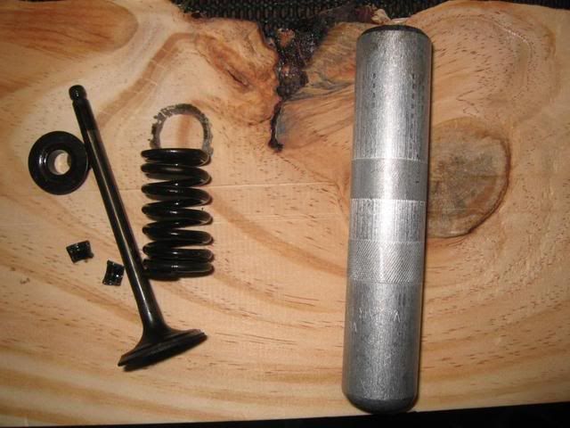

    Did a little work on the head and thought id post to show the project hasn't died yet
    Pulled out buckets and shims
    Using the infamous valve remover to compress the spring and lift out the retainers at the same time
    Note the steam seals aren't pictured and are still in the head

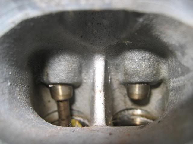

    Intake with one valve removed
    Short I know, but that's all for now
