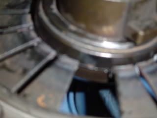

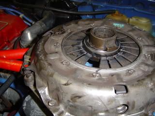

    well i finally got around to pulling the clutch out of my 23 today no wonder it went bang trying to put it on the trailer
    the thrust bearing had chewed its way through the fingers on the pressure plate
    until it said , NO MORE ,one of the fingers had disapeared altogether
    still i cant complain it had been in there for 4 years
    2 winton six hour races 3 rob roy hillclimbs 2 sandowns 4 winton sprints and 1 morewell hillclimb
    in these shots you can see how far into the clutch pressure plate the thrust bearing has chewed
    hopfully it will be back together for the winton fun day
    ian

    A silent killer?
    Usually people are obsessed with release/throwout bearing noise, but it's the quiet ones that I've seen the most damage from.
    Thanks for the pics.

    hi allencr
    it did make a little noise , i knew that it was on the way out
    but normaly you get more warning as when i went to put it on the trailer it went bang and stopped one of the fingers fell out and jammed against the bell housing
    no damage anywhere else
    ian
