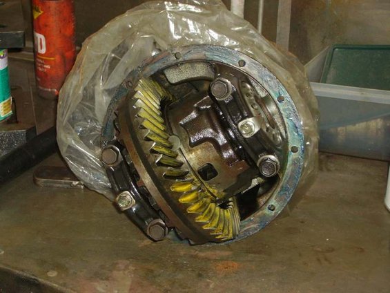

    Default Re: G series diff centre pictures anyone?
    Pretty sure this is the 4pinion clutch lsd.
    Phil
    Perth, WA
    442
    yeah indeed it looks like the photo above..
    this is the G series i have
    but there is one doubt bout it. it behave exactly like an open diff does. ie spinning one side of wheel the opposite wheel will spin the other way round. so who is who now?
    Needs to be rebuilt with clutches.
    err.. look in the hole.. or better yet, take a pic in the open hole and see if you can see plates..
    you can see the shafts for the pinions, but i am not sure it is LSD...
    ie, the sides of the housing usually look more flat.. like this
