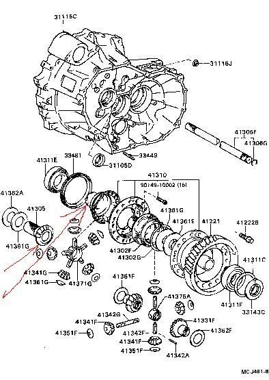

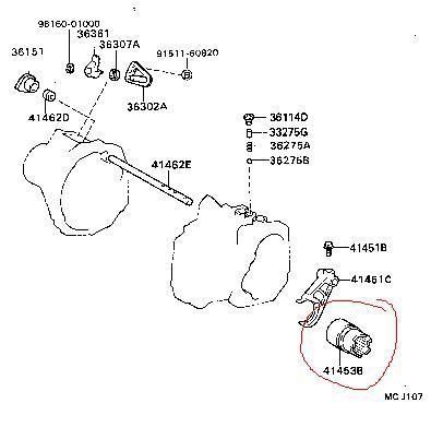

    I was recently involved in turning a ST185 GT4 into rear wheel drive only. Inside your transmission is a sleeve which can be moved to lock the centre diff. Unfortunately this sleeve becomes the weakest link in the drivetrain and is prone to breakage. This is the part I have circled. The other picture shows the (arrowed) parts locked together by the sleeve.
    To overcome the inherent weakness of the sleeve the parts arrowed were welded together.The front drive axles have been discarded and the holes plugged up. I have not driven the car but have been told it that it soon loses traction when the boost comes on.
