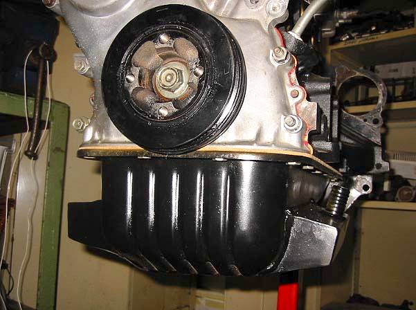

The 3T-GTE oil pumps area higher volume than any other T series oil Pump and do not suffer any sortof low pressure problems. If your pump is healthy it will be more than adequate. That brdracing oil pump is to upgrade a 2T or 3T, it probably has no more volume than your stock 3T-GTE item.
ANy 3T-GTE oiling problems are generally caused by a lack of oil itself, Prollonged high RPM can cause the oli to build up in the head and the amount of oil in the sump to become insuffient on tight cornering. A JMR winged sump will give you that little extra capacity and help with oil slosh within the sump. It would be a much more worthwhile use of your $$$.
Oh and while I think of it, Once the engine is rebuilt (if your machinist and engine builder do a decent job) then you will have quite high oil pressure from the stock 3T-GTE oil pump so I very stongly recommend ONLY using a Genine Toyota Oil Filter.
