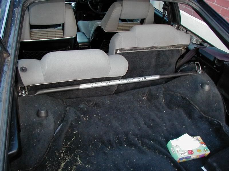

    Finished off making a rear strut bar. Just didn't get to put it in the car before the rains started Its just the same as the TSC one. Cost $8.60 for the length of steel. Then all i did was crushed the ends, drilled some holes and walla! I'll take some pics of it mounted when the rains stop.
  12. #42
    2,158
    Default Re: MA61 Rear strut bar (latch bar) specifications
    Sorry, 2 months later and i finally remember to post the picture up.
    I couldn't notice any differance with it installed. I don't know if this is becuase of the dodgy way i made it or becuase my bushes are really shagged or becuase the rear end of the car has been written off before and repaired. But i couldn't notice a differance and the only reason it stays there is becuase i can't be bothered to take it off.

    At least it looks cool
