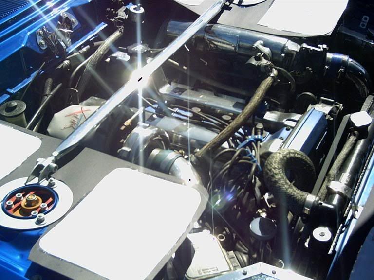

    Toymans strut brace is only a whisker from the plenum and buy the looks of it the strut hits. do you have the same brace as his?

    hey mate,
    should be able to get it under the brace, mine used to clear pretty easy
    only pic i could find with the brace on.

    hey mate,
    that is the factory intake manifold - modified obviously but the actual height of the plenum is factory. it has theflange cut out of the middle and the hole plated over - then the factory flange and throttle body was mounted on the front of the plenum.
