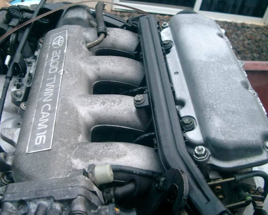

    hi
    i have just removed my engine from my aristo half cut
    and the alloy parts on the gearbox and my inlet manifold and all the turbo intake pipes have some salty corrosion stuff on them
    if there anything that removes this and brings it up clean with out polishing it or painting it
    thanks

    3,148
    Default Re: alloy cleaning
    I got the same problem at the moment, esp. after the shitload of rain we just had, and the engine being outdoors...
    I got some stuff called Blitz which is aluminium cleaner, but highly corrosive. "cleans stains and oxid(is)ation from aluminium & stainless steel"... apparently you have to dilute the mix, wear gloves and brush this stuff on. the entire intake, runners & rocker cover need a good go.

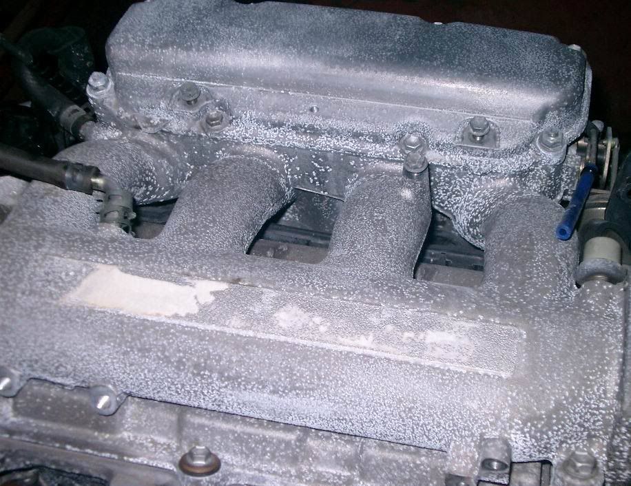

    3,059
    Some form of acid, is really required, particularly in th case of the runners in the pic above. Or you will have to use mechanicl cleaning. When Aluminium alloy corrodes, it opens up like the pores in your skin, when you get hot. Have a talk to a shop that anodises aluminium, as I know they acid wash, rinse, phosphate dip, and then anodize. The last step of the anodising process, involves "closing the pores"

    Quote Originally Posted by 30psi 4agte
    nah i doubt regular degreaser will do anything to it.
    QFT. I degreased the rest of the engine with almost two full cans of degreaser and that brought up a shine in most places as I'm guessing this engine hadn't been in an engine bay for some time. this is what the degreaser left behind... numerous cleaners of varying grades couldn't get this shit off.
    to me that warranted a stronger type of alum cleaner, which is what Blitz is. it's that bright-pink stuff which was mentioned in the other thread above, and needs to be diluted approx. 300ml to 1L of water for the job I gotta do on it.
    to be honest I was going to attack the runners with a Dremel, but I didn't wanna spoil the finish of the castings.
