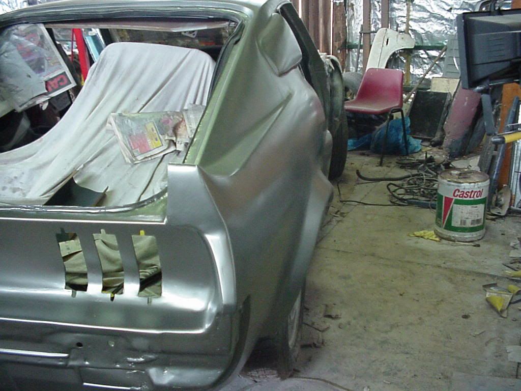

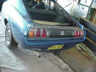

    I have genuine mustanh tail lights in my RA28
    does anyone know where to get the orange blinker for the mustang light, apparently the american blinkers are all red and don't need and orange part.?

    I'd be interested to see how real Mustang lights have been adapted to an RA28!
    Post up some pics!
    Yes, in the US cars have red blinkers on the rear. To get an amber lens you would probably have to try some Mustang importers. They should have faced this problem when complying cars for Aus. Any recent issue of Unique Cars should provide you with quite a few places to try.

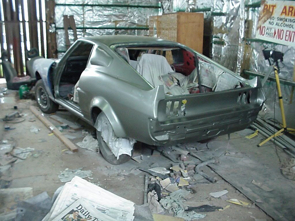

    ok will get some pics up
    I have also fitted mustang headlights and eleanored it up a bit, I think image shack hosts pics??
    The bloody thing has taken 15 months and the wife is lookin at me kinda funny like

    here are some pics
    The almost finished car will be posted tomorrow

    pics of the car are now in toymods forums members rides under My ELEANORa28
