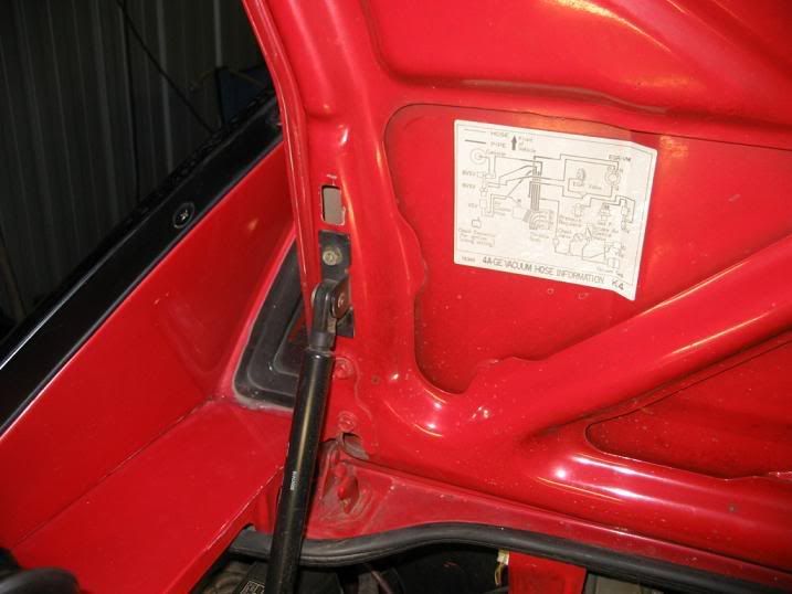

    I had some bits laying around from a mates written VTSS commondog, and noticed I could use the bonnet struts for some thing..my engine lid!
    Since my lid prop was missing on my AW11 I needed something to hold my lid up and thought the strut kit availible was a bit expensive compared to doing it myself

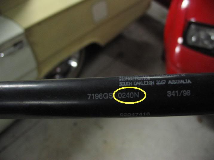

    Any strut can be used as long as it's not rated too high in pressure, here is how you can tell
    The lower the number the lower the pressure or fast but it opens quite a bit slower in warmer weather for some reason, I still think mine is a little too high in pressure, but I would'nt suggest anything rated higher than mine as you'll have trouble closing the lid

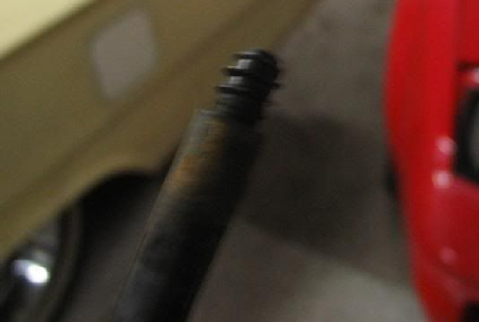

    The ends of the strut unsrew, i've used an end bracket off 2 struts so if you get a strut from the wreckers, you will have to get another end bracket off another strut
    In this pic it shows clearly the end bracket you'll need, I've used 2 short self tapping type screws with 10mm heads on the engine lid, I hope this is possible on the SC, i've never seen the underside of an SC lid?
    BE CAREFULL DRILLING THE LID!! use a broken or short drill bit if possible, you dont want to damage the top of you engine lid!

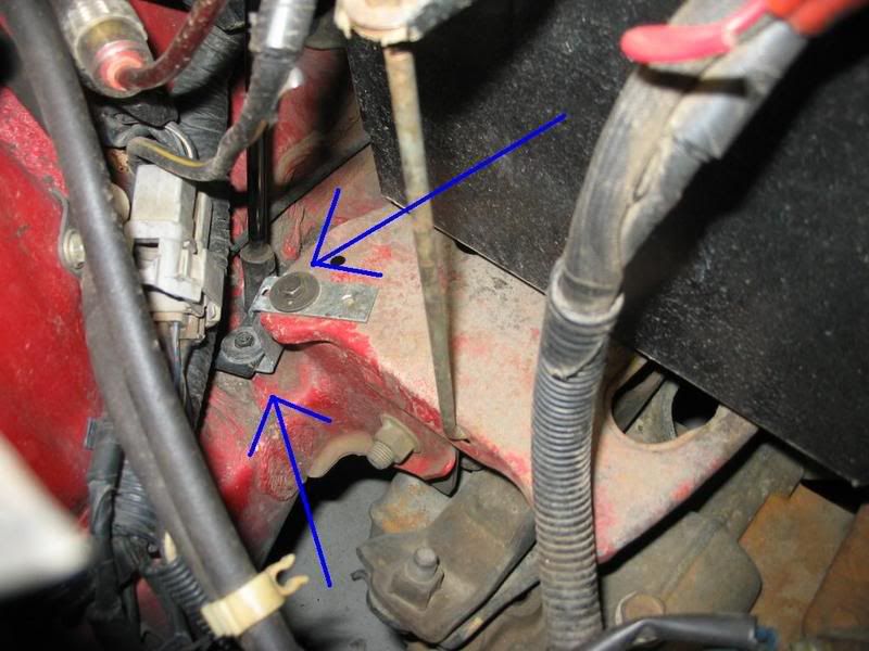

    At the bottom part of the strut you have to be carefull with clearances as the fuse box can be an issue
    The way I bolted the bottom part of the strut is a bit dodgy looking but I did'nt want drill into the rail so I bent up a piece of shelving bracket I found then screwed it to the battery tray with only 1 screw holding it, 1 screw is fine because the strut only wants to push downwards onto the screw anyway
    In the 6 months or since fitting the strut I've had no probs at all and only cost me 20 mins of my time because I had 2 struts laying around
    And the finished result!
