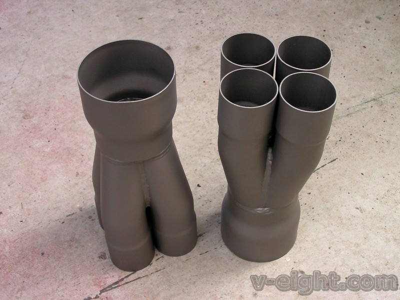

This is what we designed for our headers. It's not made yet, but it's designed for the headers to suit a Mazda 323. There is a 15deg merge with 1.75" inlet and 2.25" outlet, which expands to 2.5" over a distance 1.0" or something. Don't ask me about the physics behind it, I just designed it from plans a mate made...
Oh, and I agree, back pressure is bad, and shouldn't factor in any thought for performance tuning.

clubagreenie: looks impressive how did you come up with that design?
We bought it...
