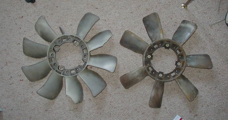

    Just a touch too close, i had to find out the hard way! Thanks for the information too. Does the 5M fan in the picture below look similar to the 7MGE fan?

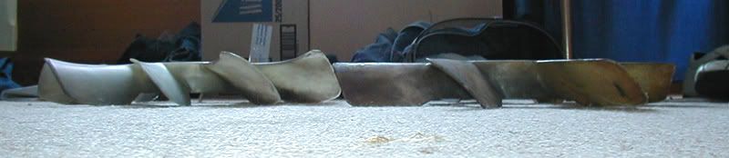

    And some pictures of the 5M vs 7M fan blades and damage pics of the fan.
    7M left : 5M right
    7M left : 5M right
    You can see in this photo that the 7M blades curve above the center 'hub' of the fan. Whereas the 5M blades sit flat and do not protrude above the 'hub'. This is what the yankies must trim off as Matt stated above.
    5M left : 7M right

    Yep, that 5M fan looks exactly like the 7MGE unit. Yeah, it's the curvy sticking out bit the seppos trim off to make them fit

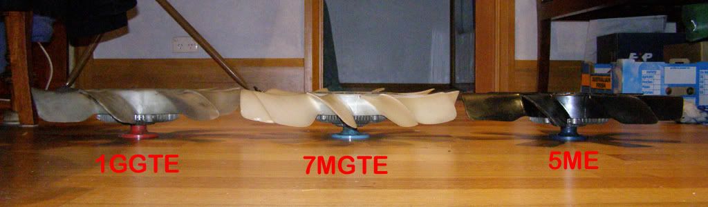

    Just updating this thread a little with the 1GGTE fan thrown in.
    Pictures of the 3 fans...
    http://i70.photobucket.com/albums/i8...TEfans01-1.jpg
    Laying on the floor.
    http://i70.photobucket.com/albums/i8...GGTEfans02.jpg
    Side shot to see height differences.
    Standing up next to each other.

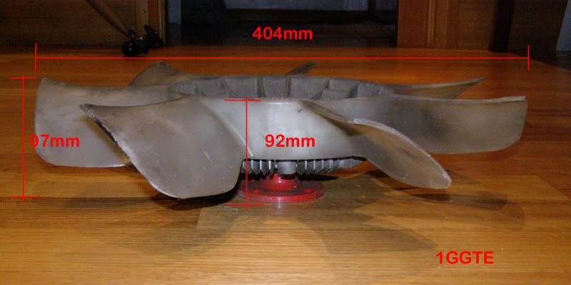

    And the measurements taken for the fans. One thing to note is that the tips that are raised above the fan hub on the 7MGTE + 1GGTE fan are only 5mm higher than the normal 5M blades.
    7MGTE fan
    1GGTE fan
    5ME fan
    Sam
