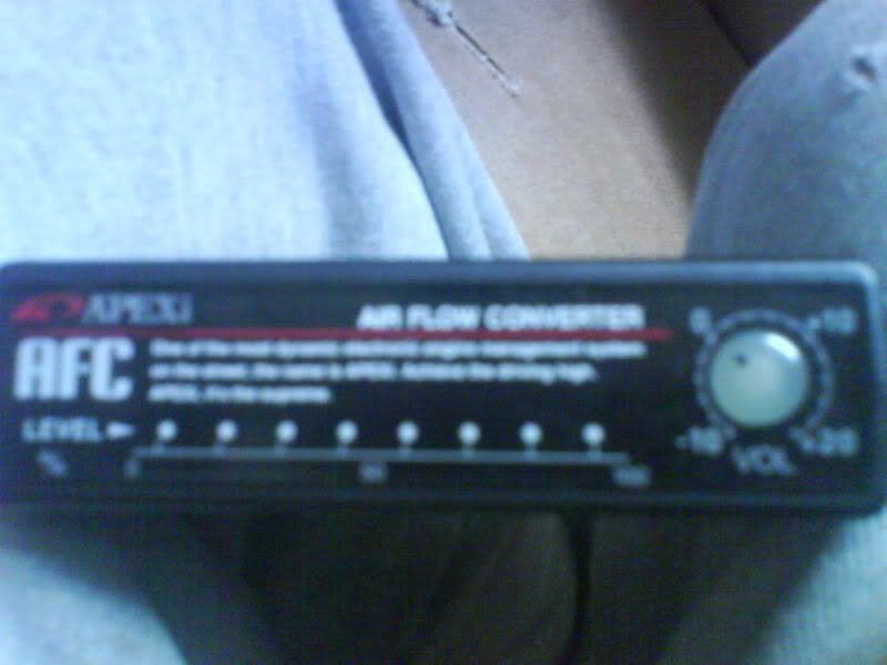

    hey guys, found this in a box full of parts that came with my soarer.
    just wondering how i install this, as me and electronics dont go together.
    has 4 wires coming from it 1 red 1 black 1 yellow and 1 white.
    im assuming black is ground red is positive and then yellow and white would go inbetween a line going to the AFM? yea? no? lol i gots no idea
    and another thing is this afc actually any good? worth the trouble of putting in?
    (sorry for the crappy phone pic)

    Not sure it'll help you since these manuals are for current APEXi products... but install manuals are at this link http://www.apexi-usa.com/support_installation.asp
    And wiring manuals are at this link http://www.apexi-usa.com/support_wiring.asp

    well from the file named english it seems i was right now i just gotta figure out which is the afm wire, and i have no fucking clue with wiring diagrams so best bet i reckon is to trace it from engine bay, but what does the afm look like?

    I have the same AFC, this manual did mine nicely, found on alltrac
    http://www.alltrac.net/manuals/SAFC.htm
    EDIT: actually sorry, didn't see your wires colours, mine had 5 wires, but its probably the closest you will find

    MAP line on engine loom should be light green from memory, get a pinout diagram, if your having trouble, i have a bunch here, tell me what your motors out of and ill scan it for you.

    engine is from a jza70 supra mate

    from my e-manage install, forgive the p00pey handwriting.
    AF is MAP line.
