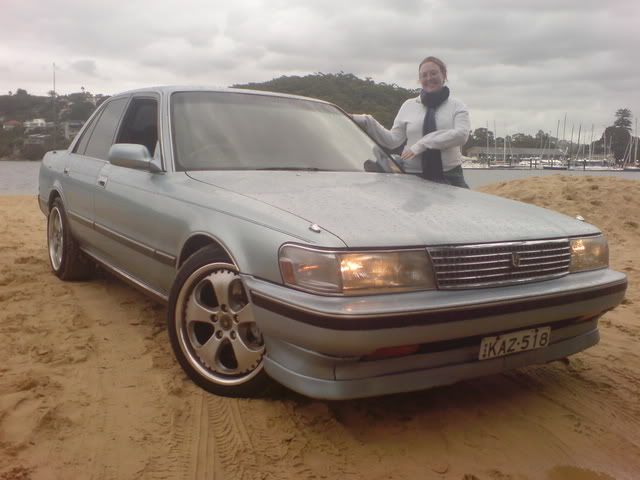

    they are b4 and after pic of our, with the KING low 25mm...
    since the above pic it has settled a bit lower aswell... now sits almost flat.

    The guard clearance in those doesn't really look bad at all I thought the king springs would lower it bugger all but 25mm seems more then what I thought, although what size tyres are you running?
    I'm currently running 205/60/15 (stock cressida tyre size) I'm probably looking at running 215/40/18's on 18x9's which would be roughly the same tyre diameter as stock so not sure how much guard clearance I'd be left with
