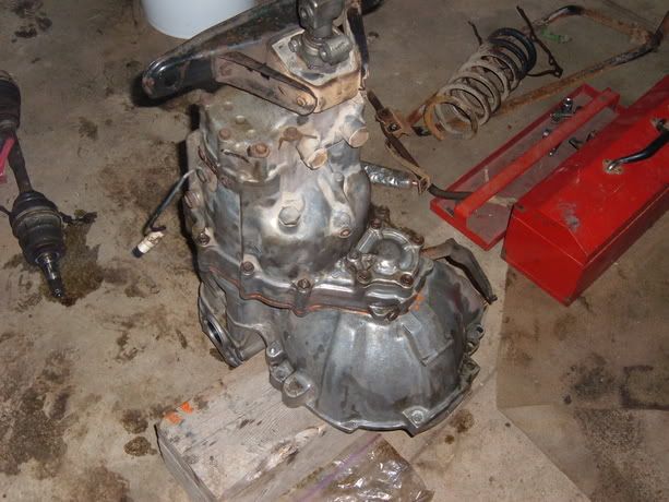

    I was thinking the "cool" factor was the main reason for the B/T, Where I am at (western Canada) Almost everything "cool" is either a Mopar (HEMI) or just adding the muffler to make your engine sound like your smackin ho's like your some sort of pimp (thwack, thwack, thwack) Makes me sick, my car is already one of the best off the line in these parts, just nothing in the long run. I do get quite a few looks driving it around (teenagers stare at the juice jug i modified and screwed to the hood for a cold air intake) There is a RX-7 in town that has problems pulling away from me. I have to laugh, this car of mine looks like such a piece of crap. HA HA.
    Not sure what kind of options i have for replacing the transmission without alot of fabbing. If your not familiar with the car here are a couple of pics of the transmission, housing and differential. The pecular thing about this car is that it is a FF but the engine is NOT mounted transversly, it is dropped in the same as a RWD.
    I will have to try with the current tranny and see how it drives, if i do need to swap the tranny i will start looking for a solution then.
