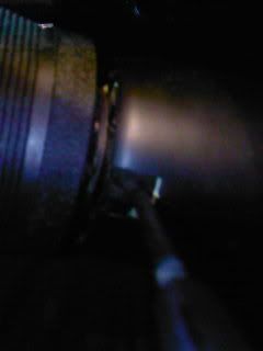

    I have a space of about 4mm between the horn pin thingy and the ring on the boss kit! at first I thought it was the incorrect boss kit as I assumed it wasn't sliding on the steering shaft far enough as the shaft tapers bigger thus not touching the horn pin thingy. SO I brought another boss kit thinking that it will fix my problem It didn't! Is it possible that the steering shaft has moved out causing the gap between the horn pin thingy and the ring on the boss kit or the outer case that holds the keybarrel and wipers etc has moved back? anyone had any problems like this? Please help

    Thanks for the replies, my indictor stalk cancel works ok, any idea how thick the pin thing is suppose to be? Mine is about 1mm, I think I might do what you said and drop some solder onto the pin and file it down. I might also diegrind a little bit more of a taper on the boss kit to allow it to slide onto the shaft that little bit more.

    I found that the autotechnica boss kit worked ok with the indicator cancel setup, I just had to align the 2 pins to slide into the holes on the boss kit! I ended up soldering about 3mm on top of the horn pin and sanded/cleaned up the edge of the boss kit and steering shaft to allow it to slide on a lttle bit more. Works like a treat!
