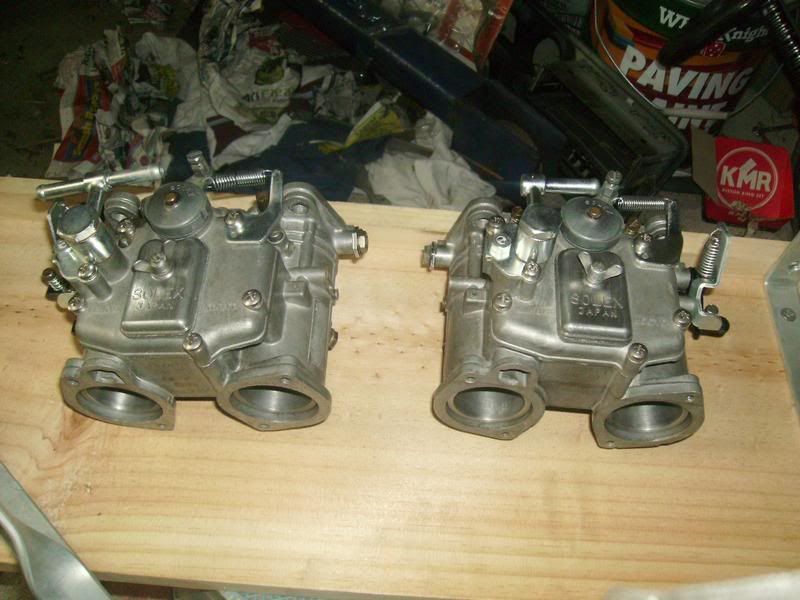

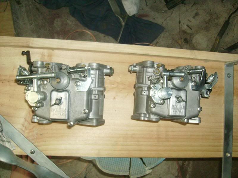

    new carbies arrived big big thanks to rodger for all his help
  4. #1339
    1,452
    shame the screws and bits aren't zinc coated... that always makes the carbies looks 10 times more awesome... good score though... always good to know your carbies are in good nick, saves alot of trouble later when your trying to tune it....

    539
    Most of the screws are actually stainless steel and some of the brackets are nickel/cadmium plated.
    I thought about the funky yellow like the original but it is hard to get them the same as the original parts. We have the cad plating done for some of our parts at my work but it does not look good to me.
    Another $50 -$100 would have seen them more "like new" as there are a lot more nuts and bolts I could be plating.
    Time V value for money issues I have.
    Enjoy them and I shall support them when the time comes to fire it up
    Regards
    Rodger
