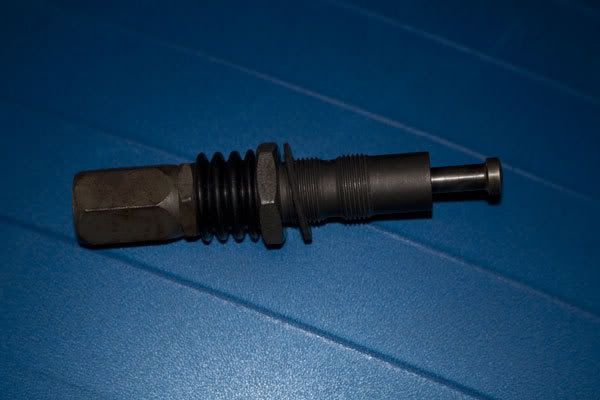

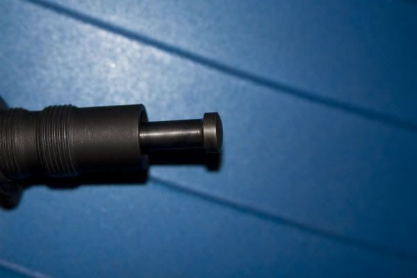

    Here's the basic concept of what is needed for the rubber backed slipper/
    Note that these are not Toyota genuine ones, I have them made up to suit a modified 18RC damper.
    The genuine toyota ones have a head that's not as thick.
    The other model, early one, has no mushroom head at all, just a domed shaft end.
    (\__/)
    (")_(")

    Cheers Steve for the pics, I did a mock fit up of the timing cover to the head with the curved tensioner fitted (the one with the cancave rubber back)
    Result is that the plunger does not contact the concave block in the middle but more towards the top edge of the block. Other than that the tensioner is the right shape and length.
    So my next question is how did you modify the plunger head? It lookslike it may work even though it will contact the upper section of the tensioner.
