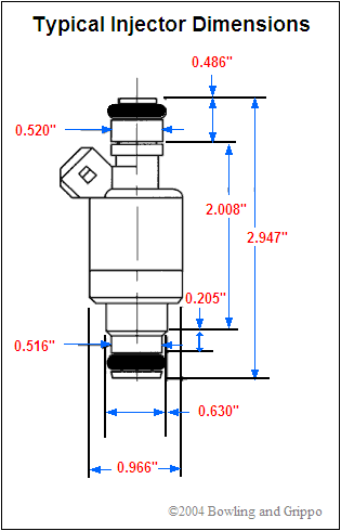

    anyone know if the stock 18RG EFI setup suits the "common" injector size mentioned on the megasquirt site?
    Just trying to decide on some cheap replacements for the stock injectors. Anything around the 300-350cc mark will suffice.

  15. #825
    6,684
    The 18RGEU injectors are low impedance type which require external resistor packs.
