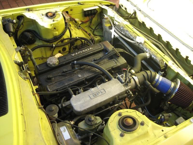

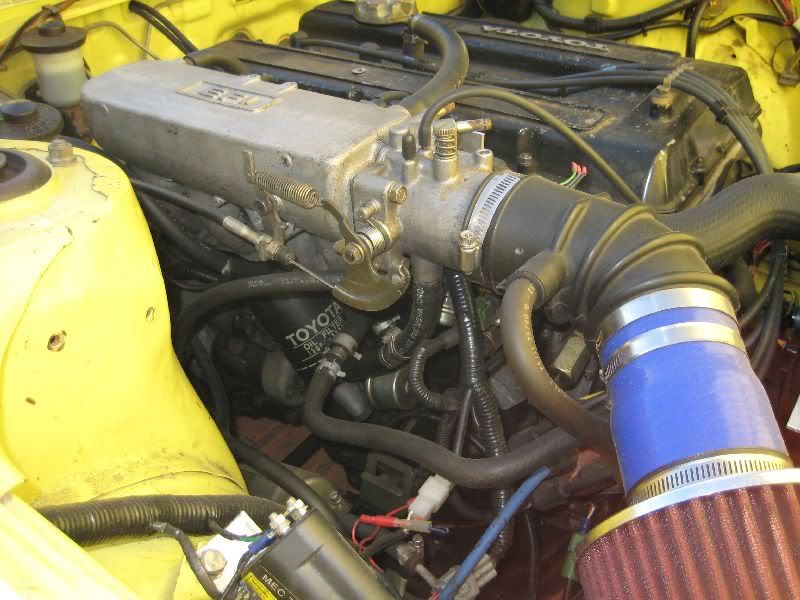

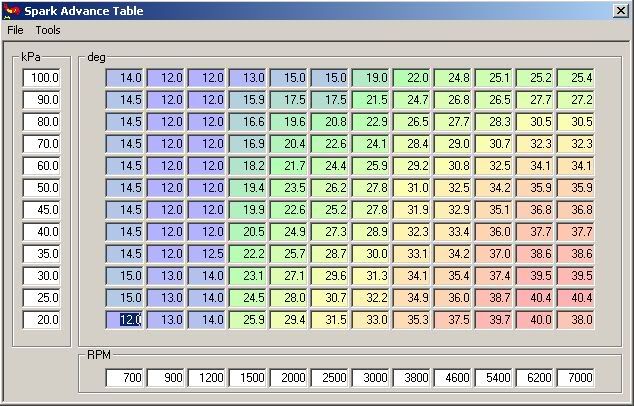

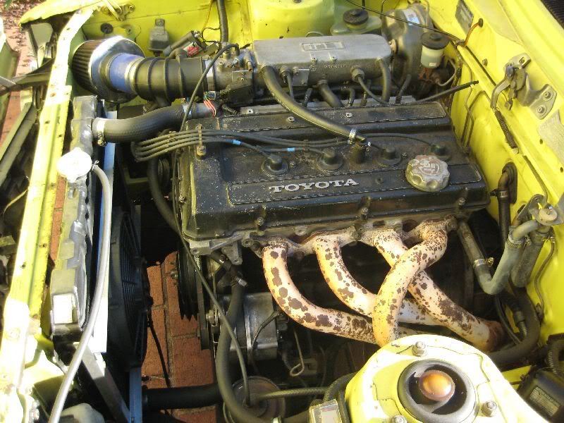

  5. #4325
    3,164
    TTV8RA23..................
    My setup was:
    - stock 18RGE
    - 9.7:1 pistons
    - stock EFI intake manifold
    - stock injectors
    - stock electronic dissy (VR signal), welded for no mech advance, with 4-pulse per 720º crank rotation (ie, standard)
    - Bosch MEC 712 coil (just your regular bosch coil)
    - Innovate LC-1 wideband O2 sensor and controller (hooked up linear 0-5V output into the MS-2)
    - Nissan Pintara TPS (from pintara that looks like R31 skyline)
    - MS-2 on v3 PCB (stock MS-2)
    With your setup, if you have made up a 36-1 crank trigger, you are best to use this for your ignition/crank trigger input. it will give the most stable and accurate signal. If you are still using the distributor to distribute the spark (ie, single coil), then you will only need to have this 36-1 trigger input, and dont worry about the dissy VR sensor for any crank/ingition trigger. It's only if you are looking to go coil per plug that you would want to look at having the 36-1 wheel and the dissy as a "home" signal to tell the MS-2 when the engine has come back to cyl 1.
    So basically... you should be able to copy many of my configurations and tables, and just adjust the configurations to suit your version of megasquirt and your 36-1 trigger input.
    I would also strongly recommend to fit a fully variable TPS. The stock 18RGEU TPS is a switch, so its pretty much useless.
    Below are some pics of my setup for reference, as well as my igntion advance table. I dont have my VE table unfortunately.... and dont have Megatune software on my laptop anymore to copy it out.
    ...... butt scratcher?!
