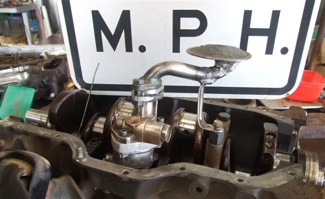

    This shot shows the modified pump sitting in the block with an extended pickup tube & screen. The pickup on the pump has been milled of at the original screen bolt flange & a much changed Pajero diesel pickup & screen coupled to it so as to put the pickup point centre, rear ,low.

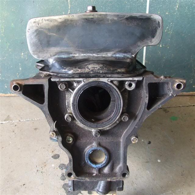

    Rear view showing expanded capacity, now 5.5 litres & drain plug at bottom most point.

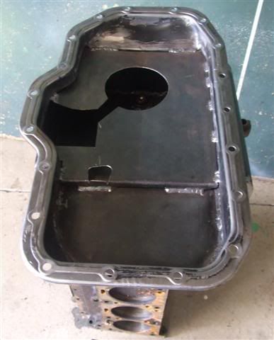

    View inside of windage tray with cut out for fitting over pickup & pump.
    After discussion with others here in the know we decided that trying to keep 5 lires of oil down in the sump under a windage tray with the centre, rear, low pick up, should work & negate the need for trap doors, verticle V arrangements & such.
    The front & rear of the sump bowl are verticle, the front drops straight down behind the front edge of the windage tray, & the rear drops at back edge of windage tray. The little cut out is for dippen shticken.
    This rear bowl job is for RN 41 hilux.
    Owen.
