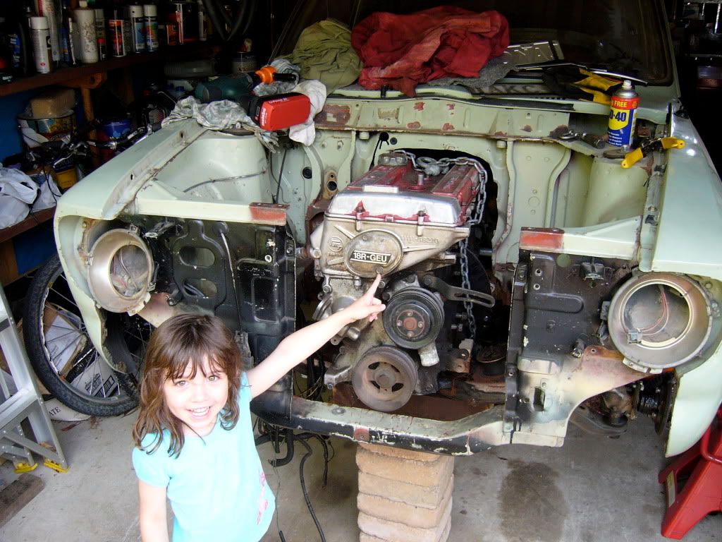

    Just to add some colour to the thread.....here's what a 2.4litre 18RG looks like from the outside
  6. #2511
    504
    'daddy spends more time on this bloody thing than with me'? haha
