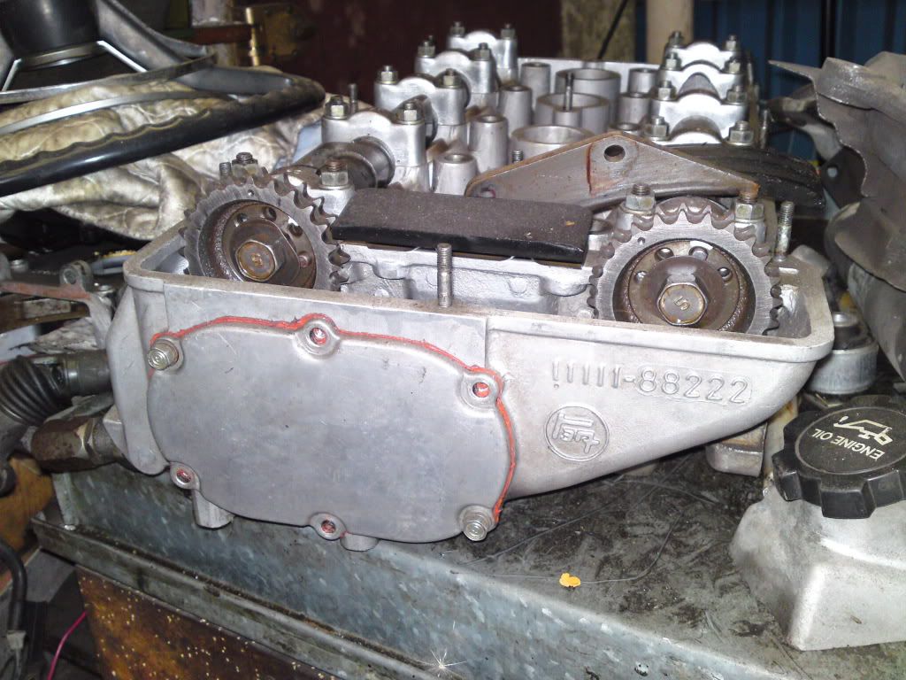

can anyone tell me what this head is off???
69 MS51 crown coupe. http://www.toymods.org.au/forums/sho...980#post835980
RA23 celica with 1JZ-GTE. http://www.toymods.org.au/forums/sho...sheepers+jza23
76 RA28 celica 1UZ, http://www.toymods.org.au/forums/showthread.php?t=12299
222 head is a 2T-G head, unless I am very much mistaken.
