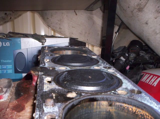

    pulled apart my -88250 18RG, seems to have had dual valve springs put in. just wondering if somebody can tell me if these are 8.7:1 or 9.7:1 pistons?

    if they are 9.7:1 it will say so on top of the piston

    614
    Those pistons have odd casting rings on the top of them.
    Are you going to take the rods out?
    Check what the casting number is.
    I'm thinking 9.2:1 maybe 18RG-R
    There was another compression ratio, but I can't remember what it was. I know the pistons were 8823?. I think these pisotns had 8.9 cast into them, but I have only seen one set and it was a while ago. They were in an 18RG-R with an 88250 head and 88231 cams.

    88230 pistons I had were 9.7:1
    88270 pistons I now have are 8.3:1
    Agreed with Steve, the casting rings up the top of those pistons are very odd, I have never seen pictures of 18R-G(add further extensions as required), or actual pistons with these casting rings.
    Your bores also look like they could use a hone.

    Hmmm as has been said they don't look like any 18RG piston i have ever seen, they also look to be a higher comp ratio than 9.7:1 as well.....you might have something interesting in there?

    i was under the impression that -88250's didn't, but -88253's received them.
    i'm suprised to hear about the pistons, looks like i'll have to take at least one out and have a looksie.
