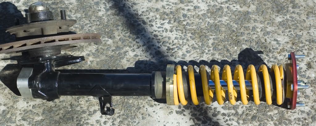

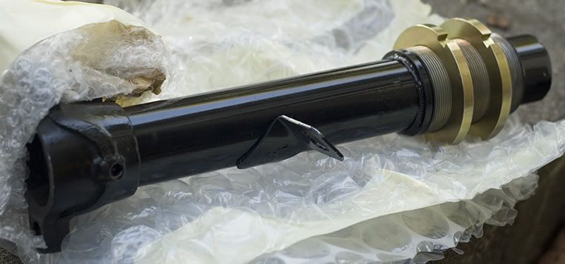

    Absolutely. Shortened to suit rear SW20 inserts, but I'm using front ones which are 20mm shorter again. If anyone is interested, here are pics:
    I think I have fixed this now. Thanks to all who offered suggestions. Absolutely no problem with the struts themselves, the spacer was a bit short, so the gland nut was bottoming out and the strut seemed tight but wasn't quite tight enough. Added a thick washer and seems heaps better. We'll see.
