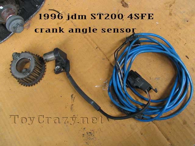

    cant remember if ive posted this but anyways
    jdm st200 3sfe distributorless engine has a crank angle sensor on the crank's cam belt pulley. this pulley fits onto gen2 3sge that i've tried so far. may need to make a mount for it tho. could be used for aftermarket distributorless ignition on 3sge and 3sgte?
