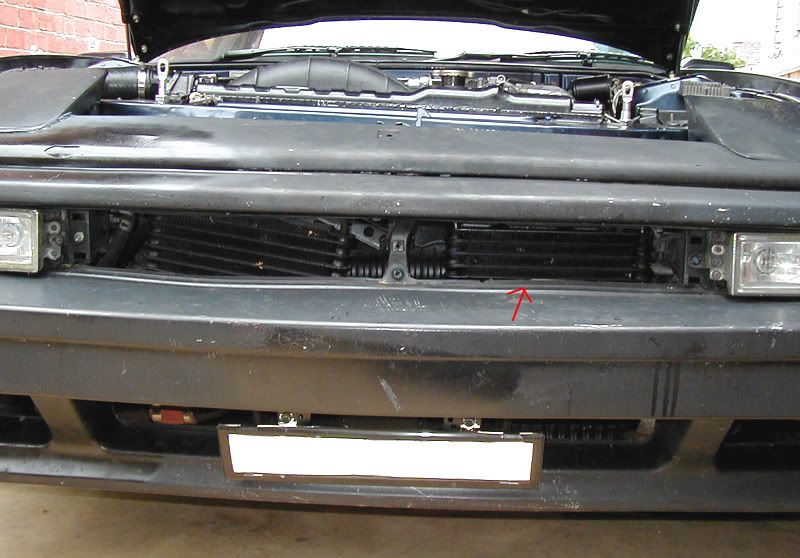

    Thanks for the input wilbo. I did get a MA70 oil cooler for the job but recently got given (thanks Psylent Knight) a slighty smaller oil cooler with outlets that better suit where i intend to put it, behind the grill. I'll post a picture up of the oil cooler and how i mount it tommorow if i get around to it.

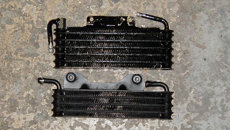

    This is the 5 row MA70 Oil cooler on top
    And the 3 row MX13/23 cooler on the bottom.
    And this is where i'm going to put it, on the right. The MA70 one on the left is an oil cooler plumbed in factory style to the 7M. Then behind all that you can see the top of the intercooler.
