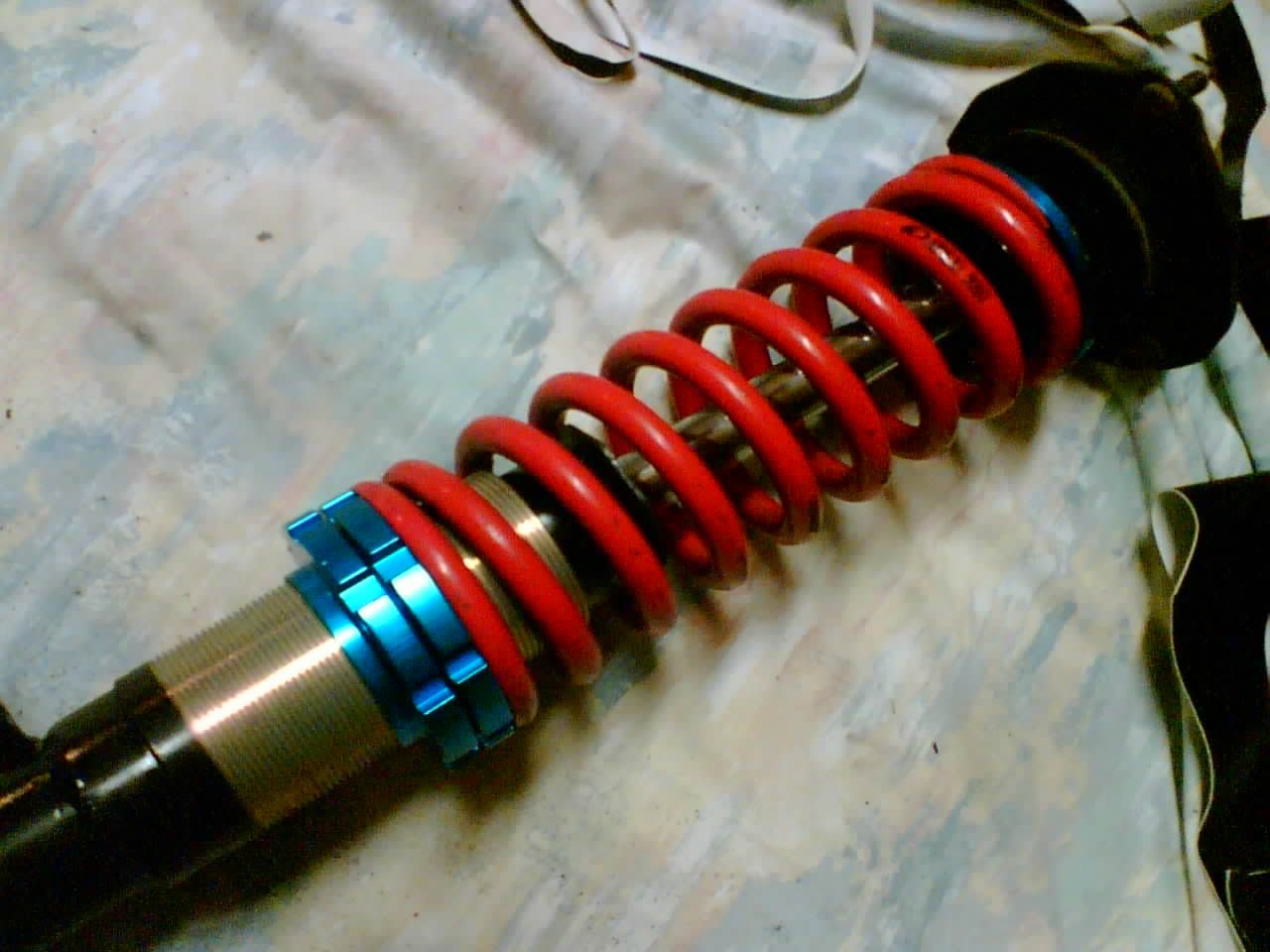

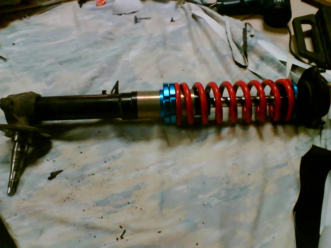

this is what you want to do, just finished mine this weekend. apexi coilover springs (~7kg)ST204 agx struts, which are 70mm shorter, cut 50mm out of the strut and used a 20mm spacer, noltec coilover hardware, sleeve sitting on a 2" steel ring, which is fully welded to the body. the sleeve DOES NOT slip on the strut, and is a very very very tight fit (had to get rid of paint, heat the thread and freeze the shock! no huge temps, but just enough. this weekend we did some pretty hard driving to see if they'll hold up (rally style) and if they didnt break then, then they wont on the road.
here are the pic's.
and
