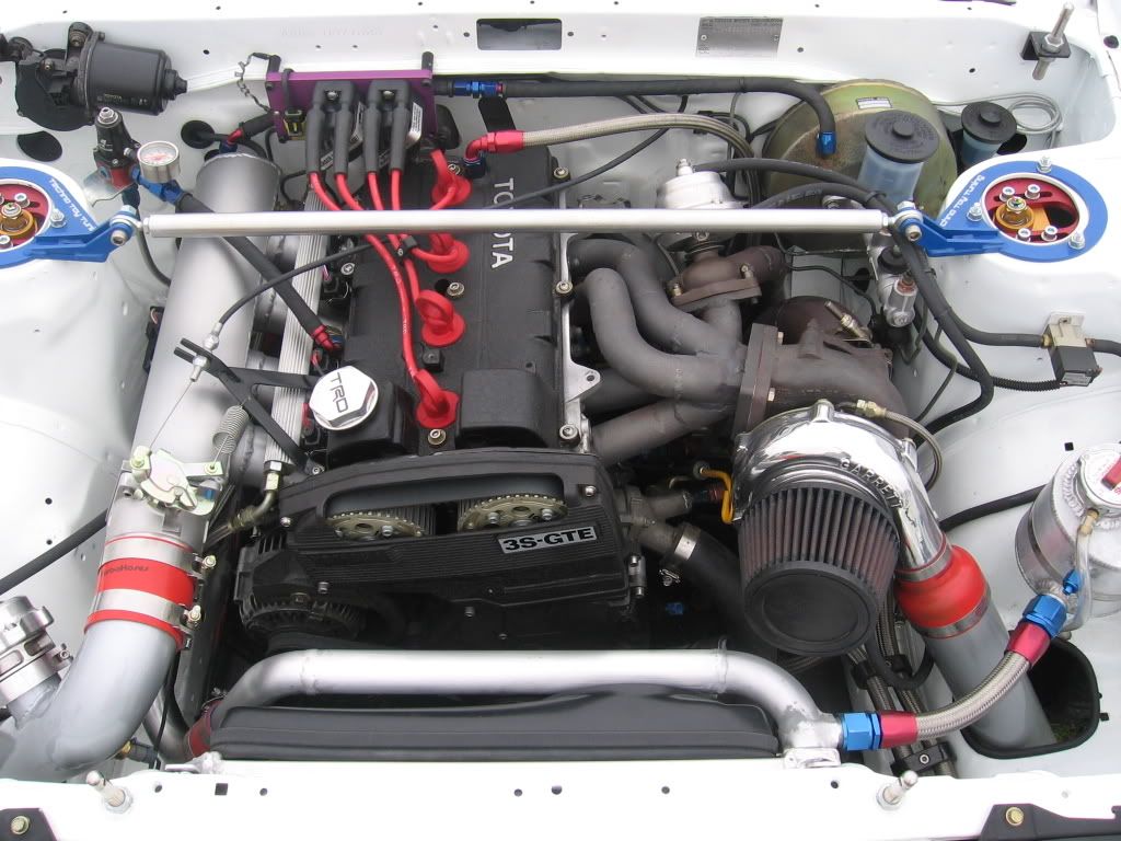

    Default Re: AE86 Race Car Engine Options?
    My choice

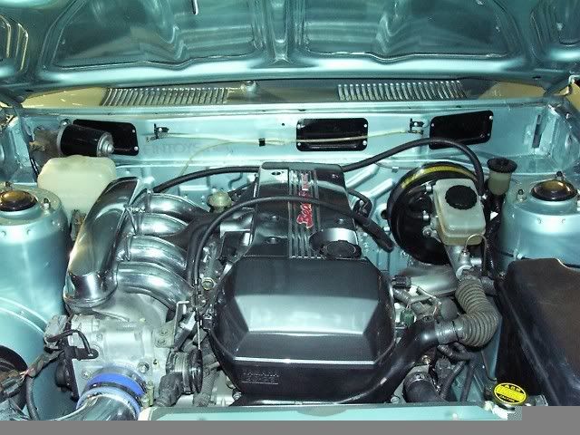

    Beams would be great choice BUT exspensive
